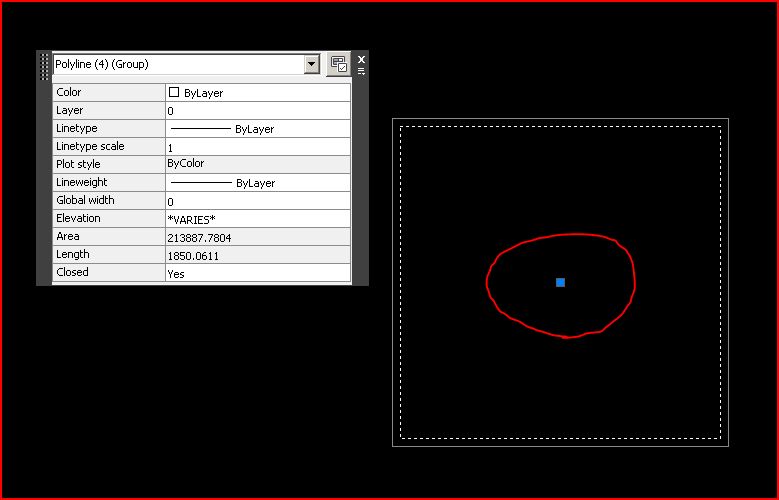

Use the GROUP command, or in 2012 Vanilla there is a GROUP flyout in the right click shortcuts menu, not sure about MEP2012. After you have created a group, there are additional command options offered in the flyout to make changes to the group definition.
rkent makes a very good point.
