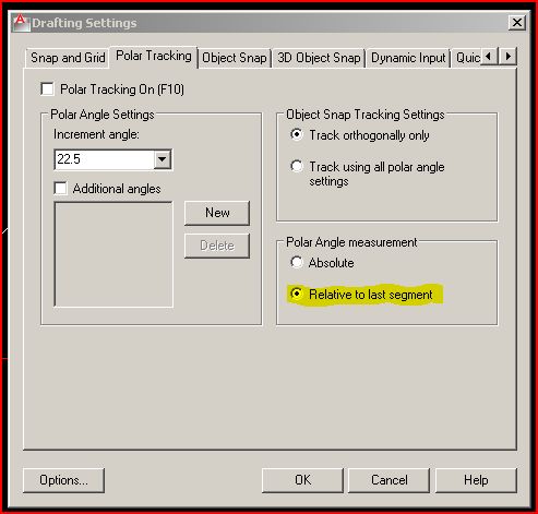

Enter OSNAP at the commandline > ENTER.
This will open your drafting settings dialog box.
Open the POLAR TRACKING tab, and you will be able to choose OSNAP relative or absolute.
The setting you are used to is Absolute, but as long as you understand why it is different, I should think you would prefer Relative. It can be a huge time saver.
