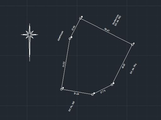

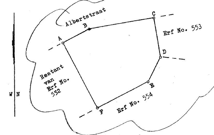

MisterJingles Posted January 19, 2012 Share Posted January 19, 2012 Hi there I received a hard copy of a simple site plan (See below) I need to recreate this in Autocad and obviously need to show which direction North is. I'm finding this tricky, I have worked on co-ordinated drawings before but never had to create from scratch. I have the co-ordinates for points A - F but cannot place the points until I set up my north. Can anyone show me how to go about setting up True North before I go about setting out the 6 boundary points? Thanks Quote Link to comment Share on other sites More sharing options...
Organic Posted January 19, 2012 Share Posted January 19, 2012 If that is all you have just take north as straight up the page as shown on the north point there, without any additional control or info you won't be able to get it any more accurate. Quote Link to comment Share on other sites More sharing options...
Tiger Posted January 19, 2012 Share Posted January 19, 2012 Coordinates are coordinates - if you have them, you don't need to know North beforehand. Or am I missing something? Quote Link to comment Share on other sites More sharing options...
MisterJingles Posted January 19, 2012 Author Share Posted January 19, 2012 Dink my concern is that when I do that, and then place my boundary points they are orientated completely differently than they show on the image above. See below. Quote Link to comment Share on other sites More sharing options...
MisterJingles Posted January 19, 2012 Author Share Posted January 19, 2012 Tiger my concern is that when I plot out the boundary points the site doesn't resemble the one in the hard copy. It almost seems a mirror image of it. I assume its my North orientation which is the problem? Quote Link to comment Share on other sites More sharing options...
eldon Posted January 19, 2012 Share Posted January 19, 2012 When surveys look like mirror images, check which order you plotted the coordinates. You might have Easting and Northing OR Northing and Easting. Try plotting in the reverse order. Quote Link to comment Share on other sites More sharing options...
Tiger Posted January 19, 2012 Share Posted January 19, 2012 Ah, now I see the trouble! I would go with Eldons suggestion, we have to have our tounges in the right mouth that at the office when we send out coordinates because the X in our CAD-drawings are the Y in the real life - but not in every town that we work in. Quote Link to comment Share on other sites More sharing options...
eldon Posted January 19, 2012 Share Posted January 19, 2012 Another thing to look for, you are in the Southern Hemisphere, are the Northings actually Southings (minus Northings) Because you can mirror your second image and then rotate it 180 degrees, before it looks like your first image. Quote Link to comment Share on other sites More sharing options...
eldon Posted January 19, 2012 Share Posted January 19, 2012 Or even your coordinates could be Westings and Southings Quote Link to comment Share on other sites More sharing options...

MisterJingles Posted January 19, 2012 Author Share Posted January 19, 2012 Yeah I have a headache too Tiger, but I also have a drawing which now works. Thanks to you guys for the help. I did have to swap my X and Y around. and also had to drop the -. Man I love coming here. Quote Link to comment Share on other sites More sharing options...
