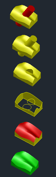

Here's a process you can use to get back to the shape you had before doing a Boolean Union.
In the sequence of images below we start with 2 solids (red and yellow). The second image shows the result after the union command.
Let's assume that both object are complex and that undo is not an option at this stage.
The third object is the result of exploding the unioned solid and deleting the surfaces that were part of the red object.
The top and bottom surfaces are then exploded and deleted leaving the lines that form the seams between the two original solids.
The "hole" lines are deleted and   surfnetwork is used to create the red surface (top and bottom) from the edges of the open side (fifth image).
surfsculpt is then used to create the green solid.
The original red object could be created in a similar process.
