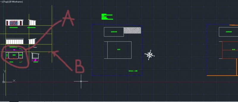

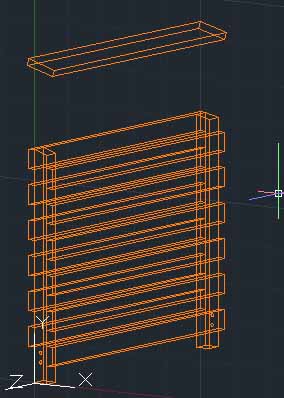

miroslav_s Posted January 22, 2012 Posted January 22, 2012 (edited) Hello, I was wondering how to extend a solid object. You can see at the picture that I attached what I mean and also I will try to explain. I draw a fence 1.5 m high. At one specific part of the yard I want the fence to be 2.0 m high. So I moved upper part (horisontal) of the fence to the height of 2.0 m. Now I want the 2 vertical poles to "extend" to that height. Now I can delete those poles and use extend command from the bottom and then use silce command. I was just wondering if their is a command that I can use to grab the pole as it is now and pull it up to the new height if that is possible without erasing it. Thanks in advance for your answers. Best regards to you all, Miro Edited January 22, 2012 by miroslav_s correction Quote
Dadgad Posted January 22, 2012 Posted January 22, 2012 There are a few different ways to do this. You should open the solid editing toolbar and explore the icons indicated on the attachment. You will be selecting a face of the 3D solid object and designating a new location for it. Quote
ReMark Posted January 22, 2012 Posted January 22, 2012 Move Faces or Offset Faces. Should you have trouble making either work you can just create "filler" pieces then union them to the existing vertical poles. Quote
miroslav_s Posted January 22, 2012 Author Posted January 22, 2012 Thanks, will try your suggestions. Quote
JD Mather Posted January 22, 2012 Posted January 22, 2012 You should also be able to Ctrl select the face and use the Gizmo to extend. Quote

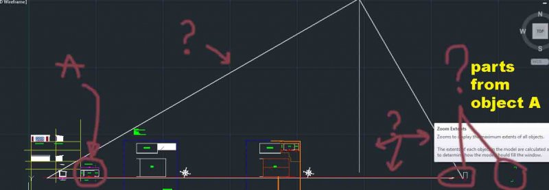

miroslav_s Posted January 24, 2012 Author Posted January 24, 2012 (edited) PART 1: Well I guess then itis my weak graphic card. I don´t know…I did try Purge and Audit. There areoptions in Purge, like for example, some layers cannot be purged. I mean, youonly got to pick the layers to purge that is offered to you. I did run evenAudit, the Autocad found 1 fault and corrected it. But unfortunately theproblem remains. Well,well, nothing more I can do. It is got to be the cardthen. This is the computers the drawinghas been tested on: COMP 1 (my comp): Alienware M11x Intelcorei7 U640 1,20 GHz RAM8 GB 64-bitswindows 7 Graphiccard NVIDIA GeForce GT 335M COMP 2 (friends comp): HP pavilion dv7 Intelcore i7 Q7201,6 GHz RAM 4 GB 64-bits windows 7 Graphic card ATIMobility Radeon HD 5650 Can you please tell meif the graphic cards are OK? What I mean I is if they can handle Autocad 2012good? PART 2: Well todayI noticed another strange thing with my drawing. When I was trying to moveobject A (picture 0) to the right to the position B all parts of object A didnot follow along. Some parts of the object A were thrown everywhere (see picture1 showing where some parts went). Why is that? I even tried with the copycommand to copy the object A and then place it somewhere else just to see butthe same thing happened. Now I tried move/copy command on anther objects andsome are copying/moving just fine and anther not. The problem is what? This is thesame drawing that I have problem rotating with the realistic view. Also what Inoticed is that Autocad seems to hang itself for a few seconds from time totime when I am working with this particular drawing. It is not the computersince I tried working with this drawing on another comp as well and autocad isacting stange with this drawing as well. I don´t know if I mentioned this but Iimported some object to my drawing from internet. It is a door object that Iimported to my drawing. Is this causing the problem? When I look at the layerproperties there are many layer that came along with this object. Thanks foreverything Bestregards, Miro Edited January 24, 2012 by miroslav_s Quote
