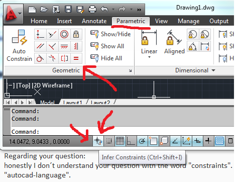

JD Mather Posted January 24, 2012 Posted January 24, 2012 ...question with the word "constraints". I mean I undestand the word in english but not in "autocad-language". See attached. Geometry constraints and parametric dimensions give you added control beyond osnaps and ortho(polar). I think Help (F1) might have additional information. Quote
miroslav_s Posted January 24, 2012 Author Posted January 24, 2012 You guys are real piece of work, in a good way of course. I just deleted 3D staket objects on those three layers and now it is the same as when I began drawing. Realistic view is working great, zooming is working great, without hacking. I will make new 3D staket objects and thistime I will be more careful. I get not what you meant with “constraints” (saw the post from JD Mather,thanks by the way!) and YES I did use this command. Thanks for the info regarding Layers,Purge, Audit and many more useful stuff along the way. Quote
