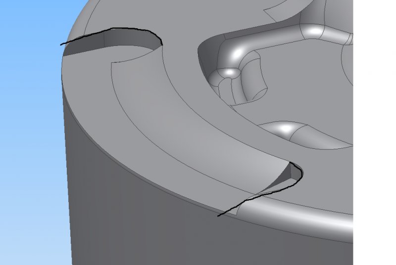

creating a non tangent fillet...
Is it possible to use fillet to accomplish this, or am I stuck using surfaces??? The radius is .75 and it needs to be tangent to the "bottom" and coincident to the edge around this pocket indicated with the black line...
I have, but it just tells me that it resulted in no meaningful results
Can you attach the file you are working on or a simplified version with only the area in question?
I would say you are looking at surfaces for this though.
Thanks for the input. THe problem is that the corner is .375 but the blend is .75.. It CAN be machined but I think you are right there, I need to use surfaces... NO biggie, just thought I would throw it out
