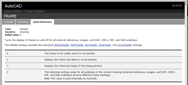

i have a dwg file, it has so many x-refs. And x-refs has so many dynamic blocks.
As you know there is a frame around the dynamic block objets. But i have many many rectangles-frames that i want to remove..
I thought that if i set it's colour to black, i could ged rid off to see this ridiculously big frames. But i couldn't.
So what is your suggestions please, thanks all.

command is FRAME. and make your selection to hide frames between 0-2.
You must have an image of some sort incorporated into your dynamic block. Dynamic blocks don't have frames.

Has anyone found out how to get rid of these frames? I have the same issue and it makes my autocad run slow. I actually had to go back to using release 10 to be able to manage file.
Any help would be greatful.
Thanks
Yes, Cios was right. Enter the command FRAME, and set the system variable to something else. 0 if you want them gone all together.
resullins...thanks for your quick reply.
I have set "Frame" to "0" and it does make the frames go away.
Question 1? I have other dynamic block named the same but frame do not show up when "Frame" is set to "1", any reason for this?
Question 2? Does this frame issue "on" or "off" make system run faster or slower?
