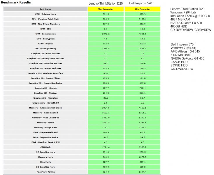

f700es Posted April 26, 2012 Posted April 26, 2012 OK the only way to really compare is to do some type of "real" comparison. I looked and found PassMark's video card comparison test - http://www.videocardbenchmark.net/. They charge for this but they have a 30 day demo mode so I downloaded and installed on the 2 machines I have access to. My Lenovo workstation and my Dell 570. Here is the result.. Quote
ReU_VOoDOo Posted August 26, 2012 Posted August 26, 2012 OK the only way to really compare is to do some type of "real" comparison. I looked and found PassMark's video card comparison test - http://www.videocardbenchmark.net/.They charge for this but they have a 30 day demo mode so I downloaded and installed on the 2 machines I have access to. My Lenovo workstation and my Dell 570. Here is the result.. [ATTACH=CONFIG]34459[/ATTACH] What is the measurement in your result? Is higher better or is lower better? Quote

f700es Posted August 27, 2012 Posted August 27, 2012 What is the measurement in your result? Is higher better or is lower better? The way I understood it, higher was better. If so this is interesting indeed. This shows my 1-2 year newer "video game" card based system with better 3D marks than the quadro card based workstation. On the flip side the quadro did better on most of the 2D tasks. The Lenovo cost 3 times as much as my Dell What a difference 1-2 years makes in computing technology. Quote
