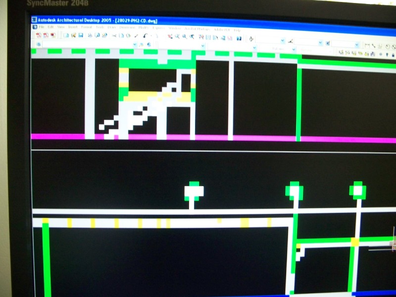

beechman Posted October 22, 2008 Share Posted October 22, 2008 I'm working with ADT 2005. Currently I'm working with a drawing file that was originally generated by another company with a newer release of ACAD. My problem is that at any given time within a viewport or in model space and, while panning or zooming, the graphics on the screen "explode" and suddenly I'm looking at something that looks worse than an early 80's video game. The image on the screen acts somewhat like a slide but as I PAN the image will change but will also not go away. I'm able to close the drawing without losing my work and re-open the drawing to the last position I panned or zoomed to. I've tried AUDIT with no results and have WBLOCKed the entire drawing to flush out any garbage without success. I suspect that we may have a station in our office that is corrupting drawings but I cannot be sure. I've taken a digital photo of my screen and hopefully it posts. Please help if you can. Quote Link to comment Share on other sites More sharing options...
rustysilo Posted October 22, 2008 Share Posted October 22, 2008 Are you able to select and list the objects? Quote Link to comment Share on other sites More sharing options...
beechman Posted October 22, 2008 Author Share Posted October 22, 2008 No. It acts like a slide if you were to view it over a drawing. You can't select what you are looking at but items behind it can be selected. Essentially you can still edit the drawing but you only see highlighted items and you can't hit escape to get rid of the slide. Quote Link to comment Share on other sites More sharing options...

rookie37 Posted October 23, 2008 Share Posted October 23, 2008 Never seen that one before Try purging as much as you can by purging wblock export out as dxf re-import the dxf Also try cutting the drawing in half by wblocking half of it. then deleting that bit. The end result will be that the drawing will be on two files. Modify it, then put those 2 files back together Quote Link to comment Share on other sites More sharing options...
mugshot Posted October 23, 2008 Share Posted October 23, 2008 you are using a cad v.07, it eat a lot of graphic card mem. ive tried using cad ver. 00,06, 07,08. and worst is 07, try to use 06 and 08, maybe your graphic card has an effect. Quote Link to comment Share on other sites More sharing options...
beechman Posted October 23, 2008 Author Share Posted October 23, 2008 rookie37, What would be the reasoning behind wblocking half of the drawing, deleting and then joining the two files? Just curious. Quote Link to comment Share on other sites More sharing options...
rookie37 Posted October 23, 2008 Share Posted October 23, 2008 I saw another problems with graphics If I work on a big drawing at home, (my computer has less grunt) if I scroll in too fast, acad suddenly does a zoom e This is because the graphics card can't keep up. It is as if Acad zooms out to study what it is looking at. This is how it was explained to me by an Autocad rep When I get this problem, I reduce the amount of graphics by turning off layers or cutting the drawing in half. Problem solved. I don't know if it will help your problem Quote Link to comment Share on other sites More sharing options...
hazardman Posted October 23, 2008 Share Posted October 23, 2008 i would say it's a graphics card issue...could be related to it's memory, driver, and/or the version of windows adt 2005 may be installed on...what are the specs of your machine?.. Quote Link to comment Share on other sites More sharing options...
beechman Posted October 23, 2008 Author Share Posted October 23, 2008 System: Intel Core 2 Duo @ 2.66 Ghz 1.98 GB RAM NVIDIA Quadro Graphics card XP Pro I've worked with many other files with far more graphics and have not had this problem on this machine. As i've mentioned, another system in our office has the same problem but that system is older and far less powerful. The big difference with that machine is that ACAD freezes and the work cannot be saved. The file I'm working on was edited on that machine at one point. Quote Link to comment Share on other sites More sharing options...
beechman Posted October 23, 2008 Author Share Posted October 23, 2008 BTW - XREFing the drawing may have worked and I'll keep you posted. Quote Link to comment Share on other sites More sharing options...
