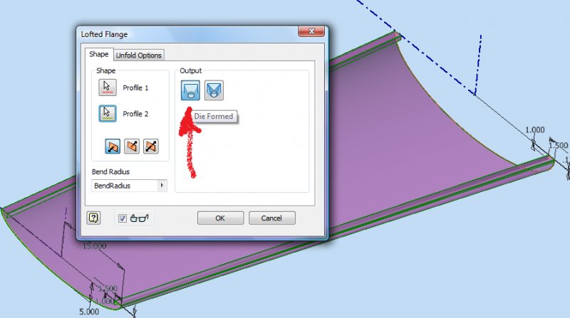

Did you change your Output to Die Formed before selecting the sketches?
Works here in 2012.
JD,
thanks.....yes I selected die formed and it still failed. fyi, when i remove the double flange's the process works. but, i get errors with the flat pattern.
Oh well! Works fine in 2012. Maybe time to upgrade?
