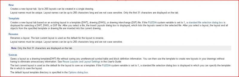

Dadgad Posted February 7, 2012 Share Posted February 7, 2012 (edited) I am having a hard time imagining why you want to have 128 layouts in one drawing. How big are these drawings? Have you purged and audited them, and done a ZERO Incremental Save Percentage SAVE. With a mind to making these drawings as small and clean as they can possibly be before this Brondignagian union. Searching the Autocad help f1 for LAYOUT I see this which might be a good place for you to start. Saving each of the existing layouts as a template, and going from there, by creating new layouts from those templates in the right click shortcut menu for LAYOUT TABS. Edited February 7, 2012 by Dadgad Quote Link to comment Share on other sites More sharing options...
