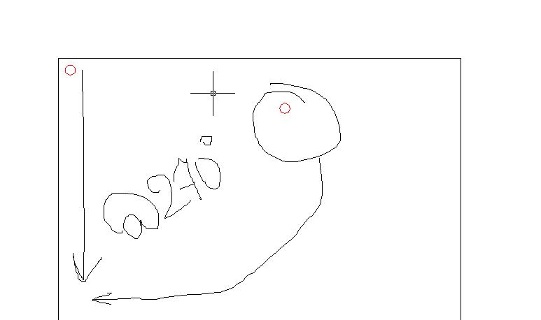

Guys I dont get why my object which is being copied at specific distance and polar angle is copied at the wrong spot. Object snap off.
(vl-load-com)
(defun rtd (a)				; Radians to Degrees
 (/ (* a 180.0) pi)
(Setq pt3 (getcorner (setq pt1 (getpoint "\norigin")) "n\corner"))
(setq pt4 (list (car pt1) (cadr pt3)))
(setq pt2 (list (car pt3) (cadr pt1)))
(command "Line" pt1 pt2 pt3 pt4 "c")
(setq insrtpt (list (+ (car pt1) 10) (- (cadr pt1) 10)))
(command "._-insert" "Q-SPRK-TYPE4" insrtpt "" "" "" )
(setq primo  (ssget "L"))
(setq  ang (rtd (angle pt1 pt4))) ;;;;;;;[color="red"];;;;;;;270.0[/color]
(command "_copy" primo "" insrtpt (polar insrtpt ang  180))
;;;;;copies at around 10 degree angle
Hint - read the docs:
polar
Returns the UCS 3D point at a specified angle and distance from a point
(polar pt ang dist)
Arguments:
pt
A 2D or 3D point.
ang
An angle expressed in radians relative to the world X axis. Angles increase in the counterclockwise direction, independent of the current construction plane.
dist
Distance from the specified pt.
Please pay attention that the ANGLE function return in radians, so there is no need to convert that value prior to pass it to POLAR.
Regards,
Mircea
