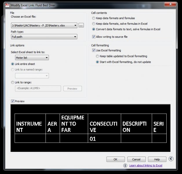

Jach
Dont worry :)
yes it is, this is how it looks when i make the link (see attach screenshot)

ReMark
Uncheck "Convert data types to text" and check "Keep data formats and formulas".

Jach
hmmm nope, still saying:
Select an option (update data link/write data link): u (i wanted to to update so pressed u)
Select objects or [Data link/all data linKs]: a ( as seen i pressed A for all )
Select objects or [Data link/all data linKs]: *pressed enter*
Select objects or [Data link/all data linKs]: Specify opposite corner: 1 found
2 object(s) found.
2 object(s) updated successfully
without anything happening.
