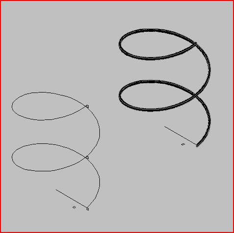

Greendamo Posted February 16, 2012 Share Posted February 16, 2012 Hi All Can any1 tell me if there is a way to sweep a rectangle along a 3D spline and keep the top of the rectangle parallel to the ground? I make complex spiral handrail and when i sweep and rectangle along a 3D spline normally, it twists and is wrong. I know that there is a plug-in on sketch that is specifically designd for this called 'Follow me and keep' Any help will make my life much better lol! Thanks Damian Quote Link to comment Share on other sites More sharing options...

Dadgad Posted February 16, 2012 Share Posted February 16, 2012 Yes it can be done without an add on. Like this? Command: _sweep Current wire frame density: ISOLINES=4, Closed profiles creation mode = Solid Select objects to sweep or [MOde]: _MO Closed profiles creation mode [sOlid/SUrface] : _SO Select objects to sweep or [MOde]: 1 found Select objects to sweep or [MOde]: Select sweep path or [Alignment/Base point/Scale/Twist]: a Align sweep object perpendicular to path before sweep [Yes/No]: n Select sweep path or [Alignment/Base point/Scale/Twist]: t Enter twist angle or allow banking for a non-planar sweep path [bank/EXpression]: Select sweep path Command: Quote Link to comment Share on other sites More sharing options...
Greendamo Posted February 16, 2012 Author Share Posted February 16, 2012 Hi Have a look at the DWG i have attached. This is the result i get with sweep, if you put it in to plan you can see that the ends are ok but in the middle of the sweep you can see is twisted out of shape! The top can't be parallel with the ground and the sides you can see are not vertical. Any ideas guys? Thanks like this.dwg Quote Link to comment Share on other sites More sharing options...
Dadgad Posted February 16, 2012 Share Posted February 16, 2012 Please try to sweep it using the sequence of inputs in my previous post. I believe that you will be pleasantly surprised. I tried a few times to loft it, but got the solid shown in the attachment by sweeping, the commandline sequence is shown. Quote Link to comment Share on other sites More sharing options...
Greendamo Posted February 16, 2012 Author Share Posted February 16, 2012 Hi Dadgad I followed the exact sequence and that is the result i got. download the dwg i have attached and try it for yourself u'll see what i mean. Thanks Quote Link to comment Share on other sites More sharing options...
SLW210 Posted February 16, 2012 Share Posted February 16, 2012 You did not leave your path and profile in the drawing. Quote Link to comment Share on other sites More sharing options...
Greendamo Posted February 16, 2012 Author Share Posted February 16, 2012 Sorry here you go.. like this.dwg Quote Link to comment Share on other sites More sharing options...
nestly Posted February 16, 2012 Share Posted February 16, 2012 (edited) I got the same result, Greendamo. I couldn't keep the top and sides perfectly horizontal/vertical, so I put a guide on each corner, copied the profile to the top, and LOFTed it with the Guide option. I wasn't that familiar with 3D splines, but it was easy to make the guides by making your original spline into block, copying it twice and scaling each of them to the inside and outside of the profile, then manually setting the Z scale back to 1. Then exploding them since you can't use blocks for Lofting guides. *edit. Looking at it closer, what I did isn't right either because the vertical distance between the guides varies depending on the incline of the spline, but I think it would work if the guides were created accurately for each corner of the profile. Edited February 16, 2012 by nestly Quote Link to comment Share on other sites More sharing options...

Dadgad Posted February 17, 2012 Share Posted February 17, 2012 Attach your "solution" here. I will be surprised if anyone posts a true solution. This is what I got last night sweeping the helix, time constrained can't play with the OP's spline at the moment. Handrail sweep model.dwg Quote Link to comment Share on other sites More sharing options...
Greendamo Posted February 17, 2012 Author Share Posted February 17, 2012 I have tried with a helix and it works ok. Its weird that it wont do the same for a 3D spline with all the same options ticked! This problem must be a hurdle for any like myself who create complex 3D helical handrail in ACAD for machining purposes. I have managed to wing it most of the time by using lofted surfaces, offsetting then, projecting my 2D plan up to the surfaces then trimming surfaces. But doing it this way is time consuming and often the surface will not offset at the complex areas like at the transition from a voloute, Or an error saying object intersects with its self! Thanks guys, ive got to get to the bottom of this Damian Quote Link to comment Share on other sites More sharing options...

SEANT Posted February 19, 2012 Share Posted February 19, 2012 What exactly is the goal? Sections taken from your solid, based on planes radiating from the center of the circle, already show the top surface to be near horizontal. The shaded model gives the appearance of a twisted top surface, but I think that is just a lighting/shading issue. The sides of your model are a bit irregular, i.e., slightly curved and non parallel to the Z axis. Though, if the goal is to have a rectangle always perpendicular to a varying pitch helix path then that would likely be the outcome. In the attached file I have set a rectangle (Cyan entity at the 10 o’clock position) and it is apparent that the top edge and bottom edge could not stayed aligned vertically as they progress around the path. Perhaps the actual goal should be for a fairly regular cross section that is allowed to morph in accordance with a top surface remaining horizontal, and sides always vertical in the radial cross sections. For what its worth, this model was made in the manner you specified in post #14 WithSections.dwg Quote Link to comment Share on other sites More sharing options...

khama Posted February 19, 2012 Share Posted February 19, 2012 I don't think it is possible. The spline is not parallel with the ground so the path will always twist it away from the ground. Is it possible to draw a spline this way? Not likely.. Quote Link to comment Share on other sites More sharing options...
khama Posted February 19, 2012 Share Posted February 19, 2012 I can get it to start parallel but it instinctively follows the path.. spline path.dwg Quote Link to comment Share on other sites More sharing options...
