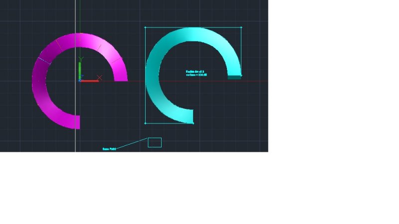

Basically the end result should be an extruded solid with the top parallel with ground and the sides perfectly in upright in Z. When you put the model in to wireframe and in plan view the lines of the extruded object will be in line with the 2D plan. If the model is correct you will be able to fit a perfect rectangle within the shape at any point and the corners of it will meet the 3D lines of the solid extrusion.
I don’t believe that is geometrically possible.
The model I attached in my previous post has a top surface parallel, and sides perpendicular to the ground (based on the radial cross sections).
I inserted the cyan rectangle such that its top edge was parallel to the Surface/Ground and tilted to be perpendicular to the spline’s path. The side and bottom edge of the rectangle project out from the perimeter thus can not produce sides that would be vertical in a swept solid.
The reason it can be done with a constant pitch helix (as in post # 13) is that the rectangle is swept in such a way that it is not perpendicular to the path. If a section is taken from the solid such that the section plane is perpendicular to the path then it would not match the original swept object.
The swept object can be compensated to allow the necessary cross section, but that can not accommodate a path with varying pitch.
You are correct Seant. The sides of the solid will be seen to project out, A square edge will never line up with a round! my mistake!!:oops:.

VaryingPerpThickness.dwg
You could if this was the geometry needed.
Nicely done Seant, I can't find any way to get as close as that by sweeping it, despite numerous attempts and variations on the numerous themes and parameters. :thumbsup:

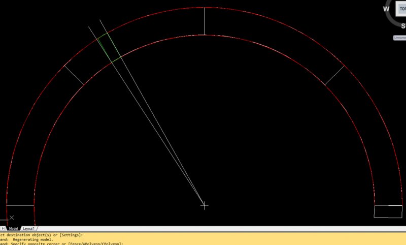

How would the issue illustrated below affect the top surface?

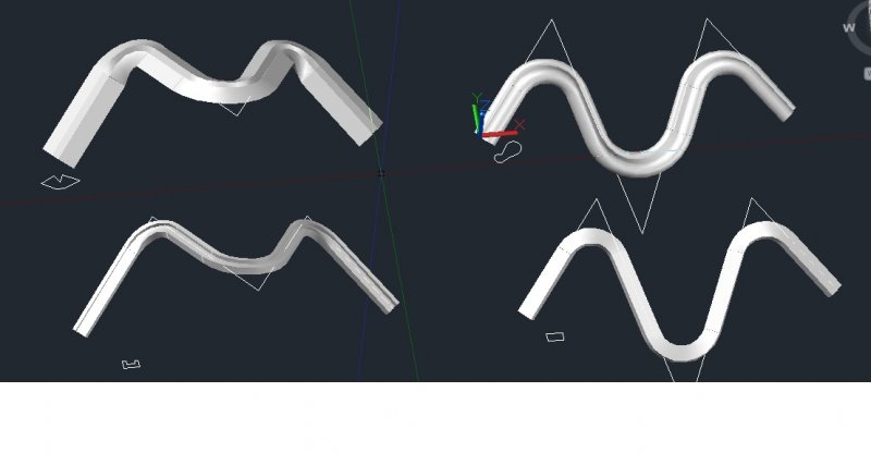

Perhaps, the easiest way to do is by using a custom autolisp
below are some forms that I have done quickly using an autolisp.
The sections are created in 3D lines and Circular Curves in 3D.

Hi Greendamo,
I am not sure this section is appropriate for posting issues regarding autolisps. However, I would like to post the drawing which I have produced with the autolisp for your review. Have a look.
SECT3D.dwg
