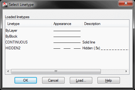

I am looking to get the linetype name from the AutoCAD LineType dialog Box, as shown below:
I want to use the LineType name - the code i have generated only returns the ID as a string - unable to find what parameter will return the line name as a string??

Perhaps like this (A2009)
      Public Function ShowLineTypeDialog() As ObjectId
           Dim xLIneTypeDialog As New Autodesk.AutoCAD.Windows.LinetypeDialog()
           Dim dr As System.Windows.Forms.DialogResult
           dr = xLIneTypeDialog.ShowDialog()
           If dr = System.Windows.Forms.DialogResult.OK Then
               Dim SelLineType As ObjectId = xLIneTypeDialog.Linetype
               Return SelLineType
           ElseIf dr = System.Windows.Forms.DialogResult.Cancel Then
               Return ObjectId.Null
           End If
       End Function
       <CommandMethod("LTDia")> _
       Public Sub TestLinetypeDialog()
           Dim doc As Document = Autodesk.AutoCAD.ApplicationServices.Application.DocumentManager.MdiActiveDocument
           Dim db As Database = doc.Database
           Try
               Using tr As Transaction = db.TransactionManager.StartTransaction
                   Dim ltt As LinetypeTable = tr.GetObject(db.LinetypeTableId, OpenMode.ForRead)
                   Dim ltID As ObjectId = ShowLineTypeDialog()
                   Dim ltr As LinetypeTableRecord = TryCast(tr.GetObject(ltID, OpenMode.ForRead, False), LinetypeTableRecord)
                   If ltr IsNot Nothing Then
                       Autodesk.AutoCAD.ApplicationServices.Application.ShowAlertDialog(ltr.Name + vbLf + ltr.AsciiDescription)
                   End If
               End Using
           Catch ex As Autodesk.AutoCAD.Runtime.Exception
               doc.Editor.WriteMessage(ex.Message)
           End Try
       End Sub
