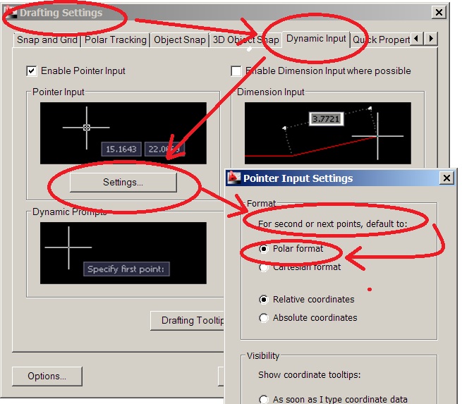

INPUTHISTORYMODE variable ... change the value from 15 (probably ;) ) to 14 ... that should do the trick
I like that, never seen it before. It looks like 15 would be okay, my guess is that the OP's value is set to 0. :thumbsup:
nope :) ... 15 is default value and doesn't work so it should be changed...14 is OK, but dynamic input must be off for that feature to work ... that was true for 2008 version and older, maybe they changed something :D
In AutoCAD, you'd also have to set the "base direction" to North instead of East to enter azimuth. (Units > Direction)
Thanks gang. None of these were how i was doing it. I am so confused. I know i was keying in the azimuths as dd.mmss I don't get it.But thanks for the suggestions.
this was great though..... This did work. Awesome.
Nestly has the solution nailed...
No. Not really. I had my dynamic input settings set to that already. lol.
