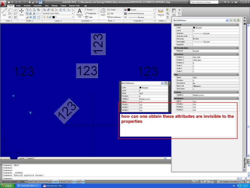

frans1954 Posted March 4, 2012 Posted March 4, 2012 how can some of the attributes in the properties invisible PROPERTIES-ATTRIBUTES-INVISEBLE.dwg Quote
MSasu Posted March 4, 2012 Posted March 4, 2012 You should enable the Constant attribure mode. Regards, Mircea Quote
frans1954 Posted March 4, 2012 Author Posted March 4, 2012 to me this was known, but is not adjusted after REGEN Quote
MSasu Posted March 5, 2012 Posted March 5, 2012 Not sure that understand what you mean… An attribute with Constant mode enabled will not allow you to modify his value. Are you saying that those attributes aren’t visible on drawing? In this case just disable the Invisible mode. Regards, Mircea Quote
frans1954 Posted March 6, 2012 Author Posted March 6, 2012 It is the intention that, when the quick properties of the various visibilitystates only the attribute INPUT can be changed, either by the other to make invisible, or is visible in the form of the standard-Name attribute. The default attribute Name can not change the quick properties Quote
