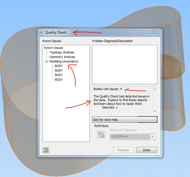

JD Mather Posted March 14, 2012 Posted March 14, 2012 In another CAD program a Quality Check returns some errors on the original geometry. What program was used to create the dwg? Quote

JD Mather Posted March 15, 2012 Posted March 15, 2012 i originally created it in adobe illustrator, then exported it as a dwg I don't think you will have much success using this workflow. Quote
