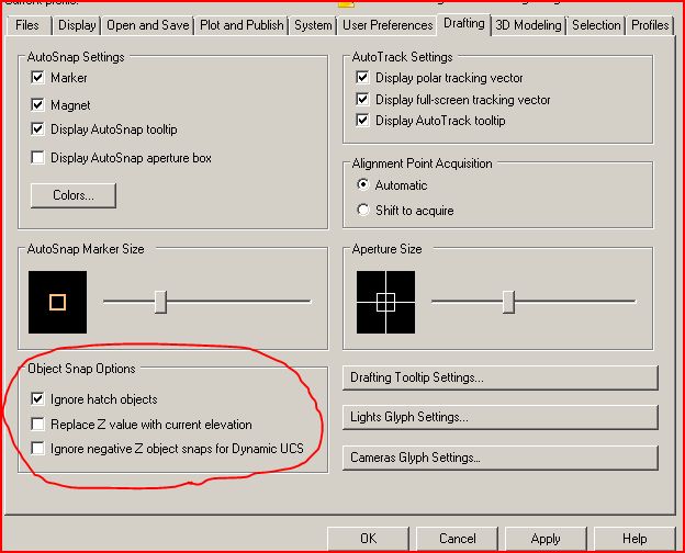

Dadgad Posted March 15, 2012 Posted March 15, 2012 I have tried FLATTEN and it does not seam to work. I did a select all and when through the properties and set the Z to 0" and that seam to work for the time being. That is how I would probably do it, that or with the CHANGE command > make your selection >PROPERTIES > ELEVATION> 0 >> You'd best take a look at your OPTIONS> Drafting tab and see how your OSNAP OPTIONS are set too. Adjust to suit your needs. Quote
