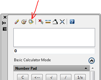

To add another option to the table; the quick calc will Paste value to command line during the command (if you have it open before you invoke your command). The calc can be used at before or during the command. See image below.
You can use QuickCalc while in your command, just right-click and choose QuickCalc and select Apply to send to command line.

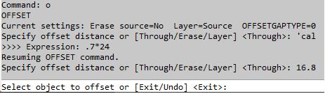

'cal might be what you are looking for.

No lisp required.
I read about this in forum but it didn't work for me.
When I type "cal" in input stage, it gives following message:
requires numeric input, two points or option key word
specify offset distance or
You omitted the apostrophe to make it a transparent command.
Type it as you see it below while in your command.
'cal
[ATTACH=CONFIG]33679[/ATTACH]
Thanks this works. The only disadvantage is that, calculator should be present before invoking the command. which is not a big problem.
