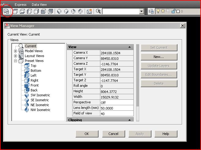

In your View Manager you can save the existing settings in the modelspace as a NAMED VIEW. In fact if you open your VIEW toolbar and check, you may find that a view has already been set up and saved. After you create your Viewport you can double click into it and set your view from the drop down view list. In order to change the view in a viewport it will need to be unlocked, and once you have set it how you want it, you should lock it so that it stays that way.
