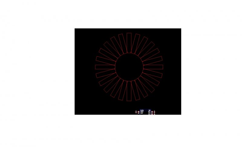

buddy4095 Posted March 20, 2012 Posted March 20, 2012 (edited) Is it me or am I going crazy ? It seems that if I were to 'polar array' a rectangle to a known center, it is arrayed OFF center . . . or am I doing something wrong ? Is there a work-around ? polar array.pdf Edited March 20, 2012 by buddy4095 adding picture Quote
resullins Posted March 20, 2012 Posted March 20, 2012 What do you mean by arrayed OFF center? Do you mean you want the rectangle to rotate as it goes around the circle like the image below? Quote
buddy4095 Posted March 20, 2012 Author Posted March 20, 2012 Resullins - thanks for the quick reply, I do not want to rotate the rectangle. Only polar array it. I have a PDF dwg attached to the original post above. . . I just cant believe autodesk people would write software like that. I can't be the only one trying to polar array an object Quote
resullins Posted March 20, 2012 Posted March 20, 2012 Yes, I see your PDF, and I looked at it. But that doesn't explain the problem. What's in the PDF IS a polar array. It will always use the start point of your geometry as the basis of the array. So in this case, I would bet that you drew the rectangle starting with the top left corner. When you're in the array command, you'll see an option for BASE. Choose that option, then pick the location on the geometry that you want used as the base point... then it will take you back to being able to pick the center of your array. Quote
resullins Posted March 20, 2012 Posted March 20, 2012 If you want to PM me your email... I can send you a video that takes you through the steps. Quote
buddy4095 Posted March 21, 2012 Author Posted March 21, 2012 Resullins, Thanks, I looked alittle harder and I see I have the 'reduced information' dialogue box, clicking on the arrows, I see the 'base' reference, defined the base and was able to polar array with no rotation. Autosketch just automatically assumes the center of every object or group of objects doesnt it? Autocad LT is still the better software to use although I am missing alot of commands of the 'full blown software'. Thanks for your help. The 'help manual' needs work. Quote
