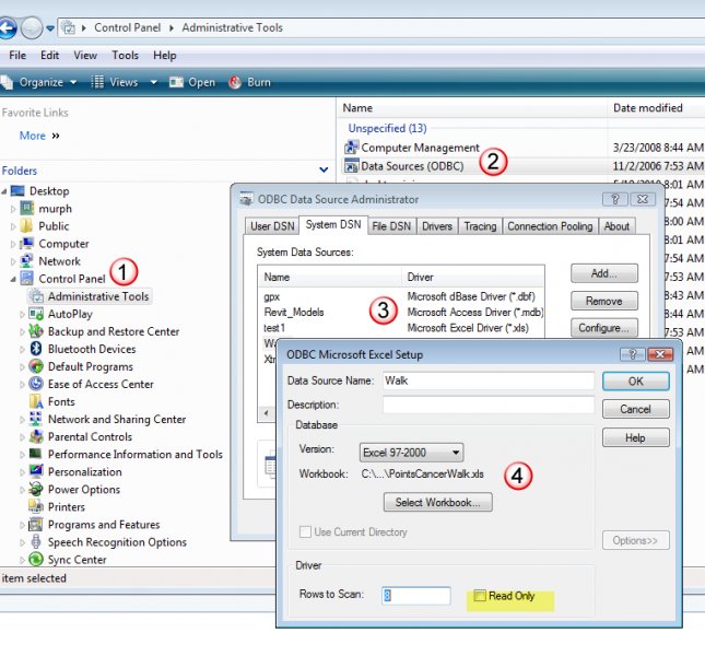

tony barretto
In Excel yoiu need to save the file(s) spreadsheets as a shared file. Depending on what version of MS Office as to how, google it or check in the help for the correct way. Then reopen AutoCAD and make the connections.
i tried it but again the same thing i.e the excel spredsheet open in read only mode. i am using ms office 2010 64bit and autocad 2010 64bit. also i am using the DBCONNECT MANAGER to link my excel spreadsheet to my drawing object, for which i need to edit the excel table from within autocad.
Share this post
Link to post
Murph_map
When you use the ODBC Data Source Administrator make sure you check that read only is not checked.
Share this post
Link to post
tony barretto

tony barretto
i have gone thru the net and it say that it is not possible to get excel in edit mode using the odbc driver as it the shot coming of the odbc driver for excel database,
You will not be able to make changes in the table; the ODBC driver for Excel doesn't support it.
This subject is usually discussed in the autocad.connectivity newsgroup.
I should clarify "You will not be able to make changes in the table;
the ODBC driver for Excel doesn't support it.". The Excel driver does
not support making changes row-by-row in a displayed table.
do u agree with this or it is possible to edit excel table in dbconnect view
Share this post
Link to post
Murph_map
I would agree with the current versions of software, years ago with older versions of Autocad, MS Office and Windows it worked. Excel is not a DataBase so do not expect it to work as a database. The last time I had it working was with AutoCAD 2008 with Office 97 on an Windows 97 workstation, and then it was limited to the number of rows in the table.
