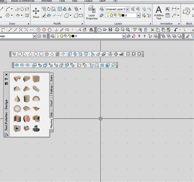

Geoffers Posted October 27, 2008 Author Share Posted October 27, 2008 screensolidmassingcrop.jpg ...don't know if I have done this correctly for screen dump.. tool palettes shows 'massing', tool bars show 'solids' and solid editing ... Geoffers Quote Link to comment Share on other sites More sharing options...
Geoffers Posted October 28, 2008 Author Share Posted October 28, 2008 ok, I am beginning to answer my own question: in that masses have to be added or subtracted by right clicking and using 'boolean'; which it seems are different routines to the similar ones on the 'solids toolbar'... ...so, still, what is the difference between 'solids' and 'massing'? Quote Link to comment Share on other sites More sharing options...
Secretagdan Posted October 28, 2008 Share Posted October 28, 2008 I do not have that version of Auto CAD, but one way to find out what sort of object it is by using the 'LIST' command. Using this will list the properties of the object you have drawn. A solid would list as '3DSOLID' when you list it. Either 'Masses' are something new in 2009, or the buttons on your tool pallet just makes a number of common solids that one could make. If it is the latter, then there would be no difference. Quote Link to comment Share on other sites More sharing options...
