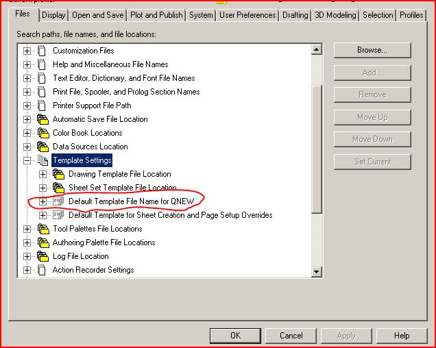

rkent Posted April 4, 2012 Share Posted April 4, 2012 I have a folder just for title blocks (.dwg) and I have a template file (.dwt) with all my settings for dims, text, layers, pagesetups, etc. The template name is set in options, files, template for qnew, so anytime I start a new drawing it grabs that template. The title block is xrefed into the template so when I start a new drawing the template brings in my settings and the title block is there as well. I also insert a block for the title block attribute text so again every new drawing will have everything I need to get going. Quote Link to comment Share on other sites More sharing options...
Dadgad Posted April 4, 2012 Share Posted April 4, 2012 Whenever you use SAVE AS CTRL+SHIFT+S you have the ability to save your file as one of about a dozen different file types. One of those AutoCAD Drawing Template (*.dwt) is the standard used for templates in Cad. Give it a name you will remember, as you will be using it again. Then, like rkent said in the previous post, set that as your default QNEW template in your OPTIONS (right click in your commandline) > FILES > ........as shown in the image. Quote Link to comment Share on other sites More sharing options...
