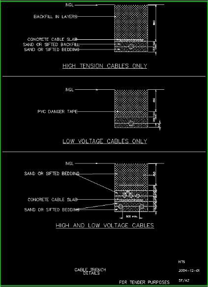

MisterJingles Posted April 17, 2012 Posted April 17, 2012 Hi all Anyone got any idea why a drawing would open without a number of objects (text) showing? I open it up and all notes are gone, yet another user opens it up in "eDrawings" and it opens fine. Oddly, when in ACAD I click OPEN, the preview ACAD gives me when I click this file once shows the missing text etc. But when I open it they're missing. Any help? Below is a screenshot of firstly the drawing open in ACAD and secondly open in eDrawings. Quote

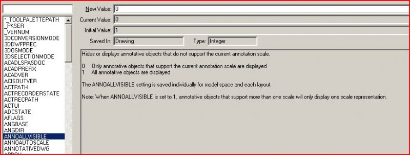

Dadgad Posted April 17, 2012 Posted April 17, 2012 Try setting ANNOALLVISIBLE system variable setting to '1'. Quote
MisterJingles Posted April 17, 2012 Author Posted April 17, 2012 (edited) Hi Dadgad. Unfortunately it was already set to "1". Any other ideas? Sorry I must add, all objects in PAPER SPACE are missing too. I have attached the file here, perhaps someone has the time to take a look? Thanks ST-A2.dwg Edited April 17, 2012 by MisterJingles Additional information Quote

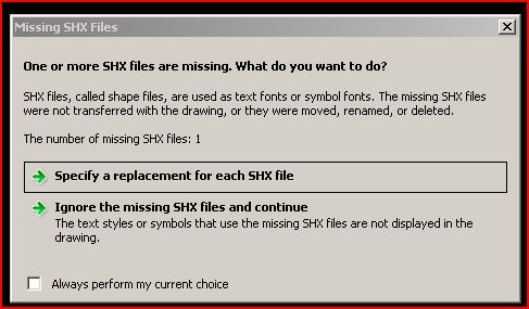

Dadgad Posted April 17, 2012 Posted April 17, 2012 I got a message that it was not created on an Autodesk product, which was followed by this missing SHX font message. Bingo ReMark! If I instruct it to ignore and continue, it looks just as shown by the OP in the first post. Quote
MisterJingles Posted April 17, 2012 Author Posted April 17, 2012 I got a message that it was not created on an Autodesk product, which was followed by this missing SHX font message. Bingo ReMark! If I instruct it to ignore and continue, it looks just as shown by the OP in the first post. Hmmm ok, I actually recall getting this a few days ago on another drawing (after doing the 2013 upgrade), I must have ignored and told it to always perform current choice. How do I go about undoing it? Quote
Dadgad Posted April 17, 2012 Posted April 17, 2012 (edited) I'm not sure how to change, or rather override your previous instruction. The only SYSTEM VARIABLES I see that deal with fonts are FONTALT and FONTMAP. If you enter SYSVDLG at your commandline you can access information on available system variables for those. I do recall Stykface having posted what appeared to be a definitively comprehensive compendium of SHX fonts, or maybe it was a link to it. If you can get your hands on that, your drawing will probably open for you. Try etransmitting the drawing from a computer that is able to open it to you, and in that way you should receive the font too, if I am not mistaken. Search for SHX fonts on the forum, or google 'MISSING SHX FILES'. Somebody will know how to reverse your preference selection. Had you specified the FONTALT to use, you would be sitting pretty. Good luck with it. Just start a new thread titled MISSING SHX FILES, and you will probably get it sorted out pretty quickly. I found that post by Stykface.......Luminous Being StykFacE's Avatar Computer Details Discipline Mechanical Using MEP 2012 Default 762 SHX AutoCAD Fonts http://www.tannarzane.com/files/749_Fonts.zip *EDIT* Until I get my file manager server resolved, I have zipped them up and offering a direct link. I have removed a few fonts that were corrupt so 749 is the grand total. I know everyone kept bugging so this is an alternative for now. Once again, enjoy. Stykface, thanks for sharing these! I hope you don't mind my copying and pasting this into this thread. Edited April 18, 2012 by Dadgad Quote
SLW210 Posted April 17, 2012 Posted April 17, 2012 Hmmm ok, I actually recall getting this a few days ago on another drawing (after doing the 2013 upgrade), I must have ignored and told it to always perform current choice. How do I go about undoing it? _OPTIONS>System>General Options>Hidden Messages Settings> Expand the AutoCAD selection then choose Missing SHX files. Quote
