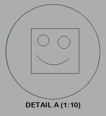

yohai Posted April 19, 2012 Posted April 19, 2012 hi people, i have the following problem: when i have a detail view on the layout, the text and the border line have the same line thickness. i want that the text will be bold (0.5mm thick) and the border line will be thicker (0.13mm thick). i have tried to change the layer's line thickness, but it effected both the text and the line border. how can i separate between them? does anybody can help? thanks, yohai Quote

ReMark Posted April 19, 2012 Posted April 19, 2012 Post the drawing. An image of the drawing is of no use when it comes to discerning the cause of the problem. Thank you. Quote
yohai Posted April 19, 2012 Author Posted April 19, 2012 see detail view from model space to layout. try to change the text thickness without changing the border line thickness 2.dwg Quote
ReMark Posted April 19, 2012 Posted April 19, 2012 It's "thickness"? Explode the object and put the text on a layer that plots with a different lineweight. You would rather do it this way.....? Quote
MSasu Posted April 19, 2012 Posted April 19, 2012 That is a proxy graphics object - you will have to edit it in the application were was created or install the required plugin. Or create an AutoCAD native viewport (MV command with Object option) and ad the label as text entity; then will be able to play with their properties. Quote

MSasu Posted April 19, 2012 Posted April 19, 2012 You are right, that proxy graphic can be exploded, so can be edited later in AutoCAD. Quote
