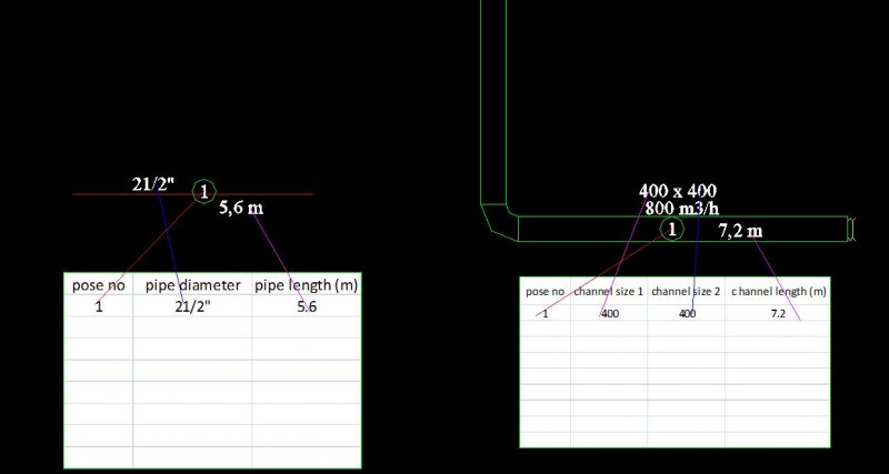

MTTLP Posted April 25, 2012 Posted April 25, 2012 I wanna kick AutoCAD to Excel from the size of the pipe and the vent channel can perform deviant lisp lisp pose no pipe diameter pipe length (m) 1 21/2" 5,6 hvac pose no channel size 1 channel size 2 c hannel length (m) 1 40 40 5,6 Quote

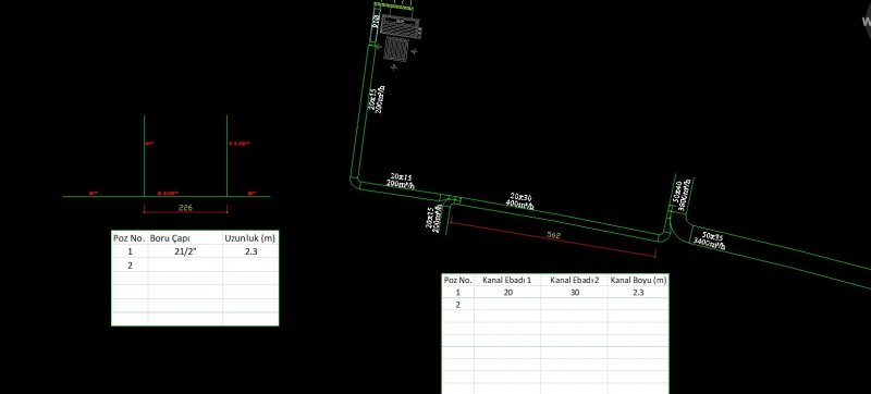

MTTLP Posted April 26, 2012 Author Posted April 26, 2012 Thank you have a beautiful but I like the image ATCA separate cells I would like to measure with which to measure the exposure number automatically ATCA lisp I and 2 when measuring 1.nokta point between the low ATCA and continue taking measurements to Excel Düzenlemeleri geri al [ATTACH=CONFIG]34452[/ATTACH] Quote

MTTLP Posted April 26, 2012 Author Posted April 26, 2012 thank you I do not know much English do not understand excuse me By measuring the dimensions one by one the names of the parts autocad to excel I want to transfer Quote

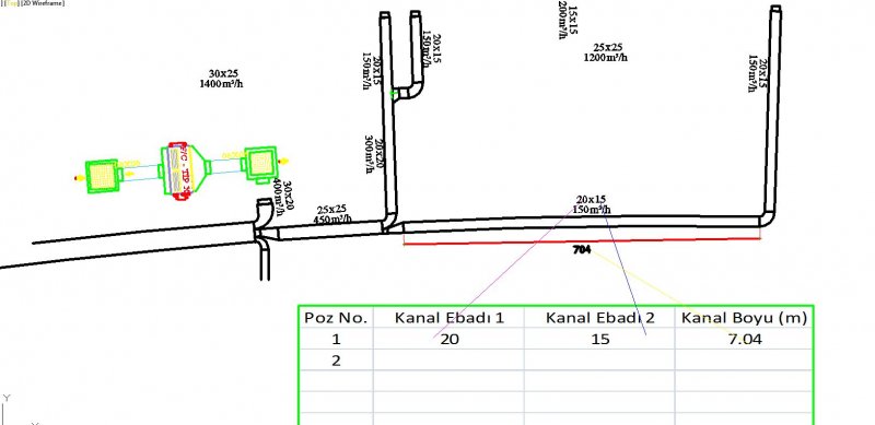

MTTLP Posted April 26, 2012 Author Posted April 26, 2012 hvac and fire systems project project I want to use 1 measure of channel size and channel point, and 2 scaling between the point I want to lisp will pass on excelle Quote
MTTLP Posted April 27, 2012 Author Posted April 27, 2012 arkadaşlar kolay gelsin sizden birşey isyetecem metraj cıkartıyorum autocad deki poz numarasını, çapı ve uzunlugunu ben seçerek excele aktaracak bir lisp istiyorum 21/2" --------------------------------- (5m) poz no boru çapı boru uzunluğu (m) 1 21/2" 5 2 ve böle devam etmesini istoyurum böle bir lisp istiyorum. Quote
