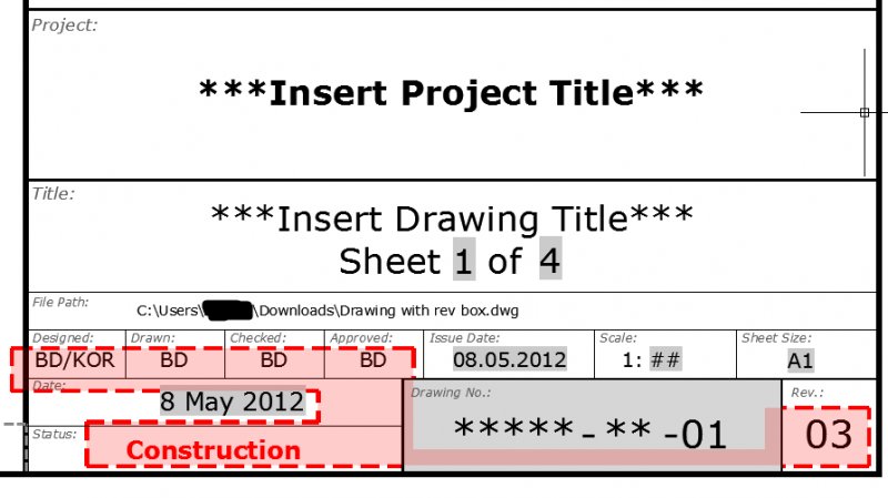

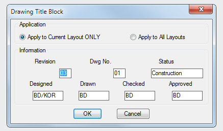

pBe, I got a bit brave and had a go at another similar type lisp but for other elements of the title block. I went back to the previous code I had from afralisp after I tried to dicipher your code but didn't have much luck. I had it working updating on the current tab and I tried to incorporate your code from post #15 (http://www.cadtutor.net/forum/showthread.php?68847-Lisp-for-Revision-Box-Need-help&p=471304&viewfull=1#post471304).
I am now getting an error
; error: too many arguments
Would you be able to have a look? I can't seem to spot the error.

Learn how to "trace" the error: Linky ---> Debugging Code with the Visual LISP IDE
Oh.. I see thats not the only problem.. I'll have a second look woodman78.
EDIT:
First use the original _sel subrouitne i posted
(defun c:title_details-01 (/)
[color=blue][b](setq ss1 (_sel "Title_Details" T T))[/b][/color]
(if ss1
[color=blue][color=black] (ddisplay[/color][b] (ssname ss1 0)[/b][color=black])[/color]
[/color] (alert
  "\nDrawing Sheet has No Attributes
          \n     Use Manual Edit"
 );if
From
(defun ddisplay (/)
(defun ddisplay ( [b][color=blue]en[/color][/b] /)
Take out this lines
;;(action_tile "rbt1" "(setq en (_sel "REV-BOX" T nil)))
;;(action_tile "rbt2" "(setq en (_sel "REV-BOX" nil nil)))
(action_tile
   "accept"
   (strcat
     "(progn (setq REVISIONa (get_tile \"REVISION\"))"
     "(setq DWGNOa (get_tile \"DWGNO\"))"
     "(setq STATUSa (get_tile \"STATUS\"))"
     "(setq DESIGNEDa (get_tile \"DESIGNED\"))"
     "(setq DRAWNa (get_tile \"DRAWN\"))"
     "(setq CHECKEDa (get_tile \"CHECKED\"))"
     "(setq APPROVEDa (get_tile \"APPROVED\"))"
     [b][color=blue]"(setq en (get_tile \"rbt1\"))"
[/color][/b]     " (done_dialog)(setq userclick T))"
(if userclick
[color=blue][b] (setq ssb (if (eq en "1")
                     (_sel "Title_Details" nil T)))
[/b][/color] [color=blue][b](repeat (sslength ssb)
  (setq edata (entget (ssname ssb 0)))
[/b][/color] ;;;;;;;;;;;;;;;;;;;;;;;;;;;;;;;;;;;;;;;;;;;;;;;;;;;;;;;;;;;;;;;;;;;;;
  (setq edata (entget (entnext (dxf -1 edata))))
  (setq el (subst (cons 1 REVISIONa) (assoc 1 edata) edata))
  (entmod el)
  (setq el (subst (cons 1 DWGNOa) (assoc 1 edata) edata))
  (entmod el)
  (setq el (subst (cons 1 STATUSa) (assoc 1 edata) edata))
  (entmod el)
  (setq el (subst (cons 1 DESIGNEDa) (assoc 1 edata) edata))
  (entmod el)
  (setq el (subst (cons 1 DRAWNa) (assoc 1 edata) edata))
  (entmod el)
  (setq el (subst (cons 1 CHECKEDa) (assoc 1 edata) edata))
  (entmod el)
  (setq el (subst (cons 1 APPROVEDa) (assoc 1 edata) edata))
  (entmod el)
  ;regen the drawing
         (command "REGEN")
             [b][color=blue](ssdel (ssname ssb 0) ssb))
[/color][/b] );progn
Hope you can put it together. Holler if you need help

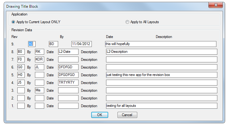

ok, here we go. Hang in there now it gets a bit messy!!
The first routine was for updating a rev box with the option of selecting one or all layouts. This is all pBe's work apart from LeeMac subroutines.
(defun c:rev_box ( / bn Adoc Layt BlkColl RevList)

This is for updating the other parts of the title block info but isn't based on a dynamic block. The basis for this code is a routine used as an example on the afralisp site.
;CODING STARTS HERE

td1 : edit_box  { edit_limit = 2;  edit_width = 2;}
td2 : edit_box  { edit_limit = 2;  edit_width = 2;}
td3 : edit_box  { edit_limit = 15;  edit_width = 15;}
td4 : edit_box  { edit_limit = 7;  edit_width = 8;}
td5 : edit_box  { edit_limit = 7;  edit_width = 8;}
td6 : edit_box  { edit_limit = 7;  edit_width = 8;}
td7 : edit_box  { edit_limit = 7;  edit_width = 8;}
title_details_01 : dialog {
label = "Drawing Title Block";
: boxed_radio_column {
label = "Application" ;    //give it a label
: row  {
: radio_button {    //define radion button
       key = "rbt1" ;     //give it a name
       label = "Apply to Current Layout ONLY" ; //give it a label
       value = "1" ;     //switch it on
        key = "rbt2" ;    //give it a name
        label = "Apply to All Layouts" ; //give it a label
: boxed_column {
label = "Information" ;    //give it a label
: row  {
   		: text {label = "Revision"; alignment = centered;}
   		: td1  { key = "REVISION"; }
   		: text {label = "Dwg No."; alignment = centered;}
   		: td2  { key = "DWGNO"; }
   		: text {label = "Status"; alignment = centered;}
   		: td3  { key = "STATUS"; }
: row  {
 	: column  {
   		: text {label = "Designed"; alignment = centered;}
   		: td4  { key = "DESIGNED"; }
 	: column  {
   		: text {label = "Drawn"; alignment = centered;}
   		: td5  { key = "DRAWN" ; }
 	: column  {
   		: text {label = "Checked"; alignment = centered;}
   		: td6  { key = "CHECKED" ; }
 	: column  {
   		: text {label = "Approved"; alignment = centered;}
   		: td7  { key = "APPROVED" ; }
      spacer ;
             : row  {
  ok_cancel ;    //predifined OK/Cancel
Title_Details.dwg
I have created columns for the dialog info but why doesn't the Revision line up with the box under it?
Updated DCL:
: row  {
: boxed_column {
: row  {
 	: column  {
 	: column  {
 	: column  {
: row  {
 	: column  {
 	: column  {
 	: column  {
 	: column  {
      spacer ;
             : row  {
Edited by woodman78
pBe, I am having trouble with the Rev-Box routine in that when I run it it works fine. But then if I close the drawings and reopen it I get nil when I run the command. Is there a way to incorporate the wildcard selection for the block and would it help?
Thanks.
Thanks.
We dont need to apply wildcard matching on this routine woodman78, as the code does not "select" the blocks but instaed it "reads" every block.
My guess is the block names are diffrent (setq bn "rev-box" Visname "Visibility1") . if its "Rev-box" then i would suggest we change the line to
(setq bn "REV-BOX" Visname "Visibility1")
and (eq (vla-get-EffectiveName itm) bn) to
(eq [b][color=blue](strcase[/color][/b] (vla-get-EffectiveName itm)[b])[/b] bn)
or if you're not sure which block you are using on a drawing like "REV-BOX" or "REV_BOX" . Then its this way
(setq bn "[b][color=blue]REV*[/color][/b]" Visname "Visibility1")
and
([b][color=blue]wcmatch [/color][/b](strcase (vla-get-EffectiveName itm)) bn)
I have added the block to our template file (dwt) and when I import the layout and run the command I get "nil". The block name in the drawing is "rev-box" and it is exactly the same in the code "rev-box".
