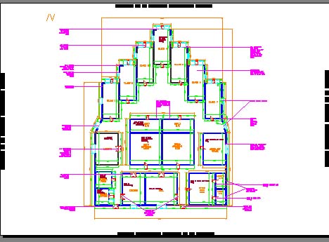

mo12345 Posted April 25, 2012 Posted April 25, 2012 so i am a student that has a submission due tomorrow but i cant seem to scale my drawing to fit right on an A3 sheet of paper i have done the drawing in mm its my first project i will upload the file upon request Quote

mo12345 Posted April 25, 2012 Author Posted April 25, 2012 (edited) c-m school latest recovered 2.dwg i did draw the drawing to full size and i tryed view port but when i tried to export as a pdf it looked like something made on microsoft paint edit: i uploaded a copy of my project to make more sense of the problem and i would like it at a scale of 1:50 / 1:100 also maybe someone can create the viewport better than i did. Edited April 25, 2012 by mo12345 Quote

ReMark Posted April 25, 2012 Posted April 25, 2012 I changed the sheet size from A4 to A3. I tried both the 1:50 and 1:100 scales but your drawing did not fit. I created a new scale via SCALELISTEDIT of 1:200 and it almost fits (landscape) but not quite. What do you want to do? Quote
mo12345 Posted April 25, 2012 Author Posted April 25, 2012 urmmm i think ill see how it looks in 1:200 and take it from there edit: is there anything i can do to resolve the problem ? so tried it alot of it does fit and some of it doesnt, what can i do about the hatchings i cant see them at all Quote
eldon Posted April 25, 2012 Posted April 25, 2012 I was going to suggest 1 to 250 scale. There is no problem. For scaled drawings, you cannot fit a quart into a pint pot. Quote

mo12345 Posted April 25, 2012 Author Posted April 25, 2012 well i just need this drawing to fit on an A3 piece of paper by any means possible lol, i understand what you were saying about using a larger piece of paper rather than scale the drawing smaller and i think that would be better but an A2 size hand in would be unlikely. thanks all i know what was the problem plot object line weights was on making all text extremely thick Quote
