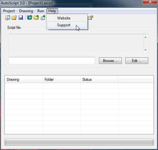

The only mentions I can find on AutoDesk's website of "AutoSCript" is in the forums where users suggest using it instead of ScriptPro, or where they're refering to the abandoned AutoScript which last worked in R12-R14 in the mid to late 90's: http://usa.autodesk.com/adsk/servlet/u/gsearch/results?siteID=123112&catID=123155&id=2088334&qt=autoscript
That's not the one which we are talking about. The program called AutoScript (at least the one we're talking about) is made by the company called Cadig, they just used the same name as that old one which is no longer in production by AutoDesk. Again you obtain it from the Cadig website (not from AutoDesk). Browse to the bottom of this page to get their newest version 3.0: http://www.cadig.com/download/#dw_as
Even if I click the Help>>Support option inside the AutoScript modeless dialog (inside AutoCAD) it opens a mail to support at cadig.com. Not to autodesk.com.
If I click on the "Website" option it opens this page: http://www.cadig.com/
Again: Cadig ... NOT AutoDesk ... unless ADesk bought them out at some stage .. which none of us know about as yet.

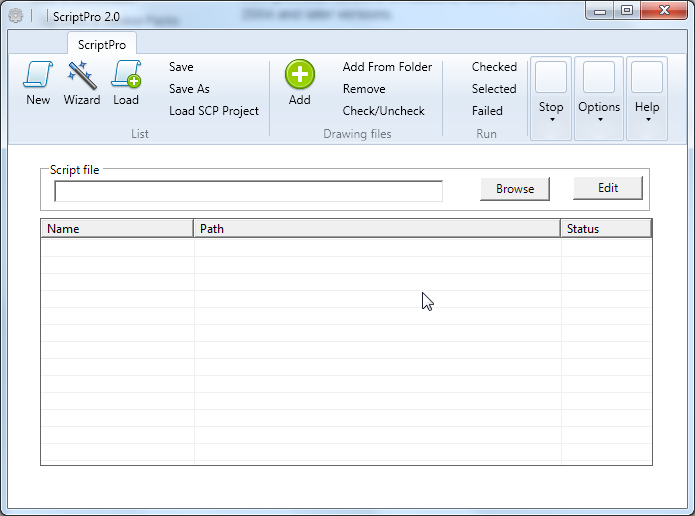

AutoDesk's own program (Script Pro) is an entirely different thing which runs outside of AutoCAD:
You can download that one from AutoDesk's web site: http://usa.autodesk.com/adsk/servlet/item?siteID=123112&id=4091678&linkID=9240618
See it's called ScriptPro 2.0.
