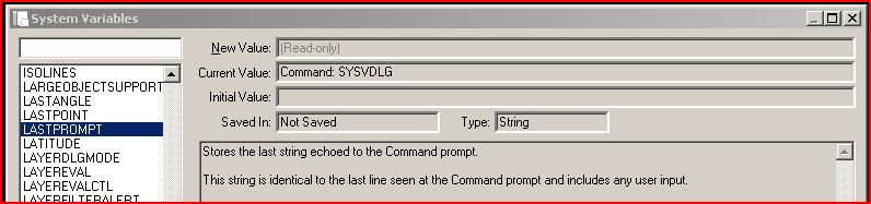

It looks to me like there is no way to adjust this prompt, based on this image from the SYSVDLG. Seems to be read only, without variable options. If you have just created an object it will be selected, as you are well aware.
