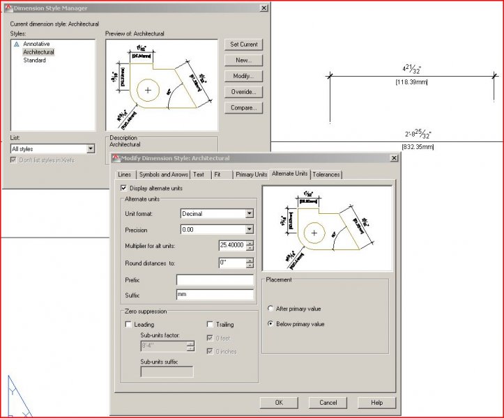

Hello to all, this is Vangelis from Greece. We took a new project, a bistro at Miami, USA. We must deliver plans, sections, details etc for construction and the problem is that we are not familiar at all with inches, feet etc.
If anyone has some experiance on this, do you think that it would be ok to sent our work in centimeters, or it would be impossible for the contructor to build?

From my experience with american companies I am inclined to say that you should make your drawings in feet and inches. And you should use fractions instead of decimals: 1'-3 1/8" instead of 15.125". You should probably break your fractions down to at least 1/16", maybe even 1/32", though I doubt that contractors work that fine.
You definitely want to use Imperial dimensions.
The good news is that you can make the primary units IMPERIAL and create an alternate dimension style which will give all dimensions in metric units.
The sample shown reads FEET & INCHES on the top of the dim line and MMs on the bottom.
Probably not exactly how you should or want to do it, but to give you an idea, that it is quite simple to do.

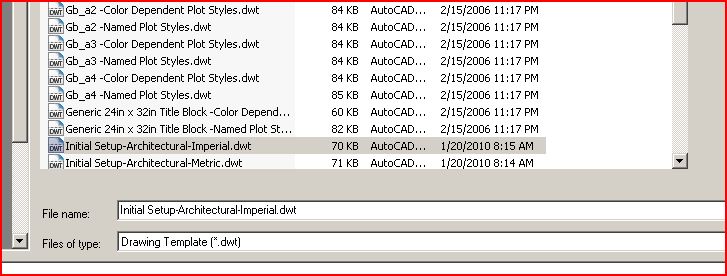

I started a NEW drawing, for which I chose the ARCHITECTURAL - Imperial template as shown in the attachment.
The alternate dimension display can be turned off when drawings are sent to the client, and you can turn them on when you are working on the drawings.
I would suggest starting on an IMPERIAL based template instead of an ISO based one, as it will be better for the client.
I have attached the .DWG shown in the images, so it is on what I should think would be an appropriate template, and contains that dimstyle.
Definitely show fractional values, and I should think that to 1/32" would be best, depending on what the project is, and what the contractor asks for.

The dimension style which is included in the .dwg file attached in POST #3 shows metric and inches, just use that and build and design it as you usually would. :)

Just remember that if you want to you can turn off the ALTERNATE DIMENSION DISPLAY at any time on the alternate units tab, as shown, you can.
In that way if they don't wish to see the metric dimensions they don't need to. :)
