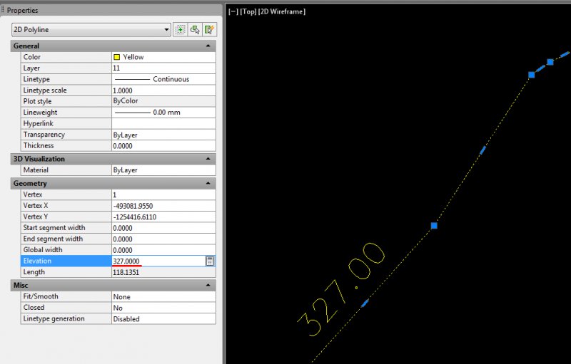

wishgranter Posted May 8, 2012 Share Posted May 8, 2012 Hello all i got 2D map of ruinded castle - terrain in DWG format. is there a way to get it in 3D to get the Z-info automaticaly ? the levels are defined i hope see screengrab http://dl.dropbox.com/u/15047343/2D%20map.jpg Quote Link to comment Share on other sites More sharing options...

SEANT Posted May 13, 2012 Share Posted May 13, 2012 That file requires some work. The contours have no differentiation to allow automation. Map 3D may have tools to help the process; I don’t have Map, so I can’t say for certain. I can say that standard AutoCAD does not have the necessary tools, and I’d be surprised if there are any available custom applications. The situation may be such that the only recourse is to set each contour’s elevation by hand (see Elevation in the properties palette). Once those contours are correctly positioned, though, there are a couple of possibilities to generate a 3D surface. Quote Link to comment Share on other sites More sharing options...
wishgranter Posted May 13, 2012 Author Share Posted May 13, 2012 hmmm, yes, that option is aviable even in ACAD, can get manualy. im searched for some automation - is there a way to set something as quick preferences - just to change height - mean im click and just enter the height ? Quote Link to comment Share on other sites More sharing options...
SEANT Posted May 13, 2012 Share Posted May 13, 2012 The process isn’t too bad via the Properties Palette, just select the poly and set the elevation. You will have to determine the elevation for the intermediate contours. Quote Link to comment Share on other sites More sharing options...

Murph_map Posted May 13, 2012 Share Posted May 13, 2012 Hello. im downloaded the Autocad MAP 3D 2013 - trial - can help to get the data to 3D terain ? im trying to find tutorial on net but without luck. can upload the file..... AutoCAD Civil3D would be the better app to do what you need. If you try the trial version look at the tutorials on creating civil3d surfaces, and post in the Civil3d/LDD forums for help. Quote Link to comment Share on other sites More sharing options...
motee-z Posted May 13, 2012 Share Posted May 13, 2012 here is a lisp i use it long time ago it work well it move line polyline from level to another level mclln.LSP Quote Link to comment Share on other sites More sharing options...
SEANT Posted May 13, 2012 Share Posted May 13, 2012 Nice routine motee-z. That will certainly speed up the process. Quote Link to comment Share on other sites More sharing options...
