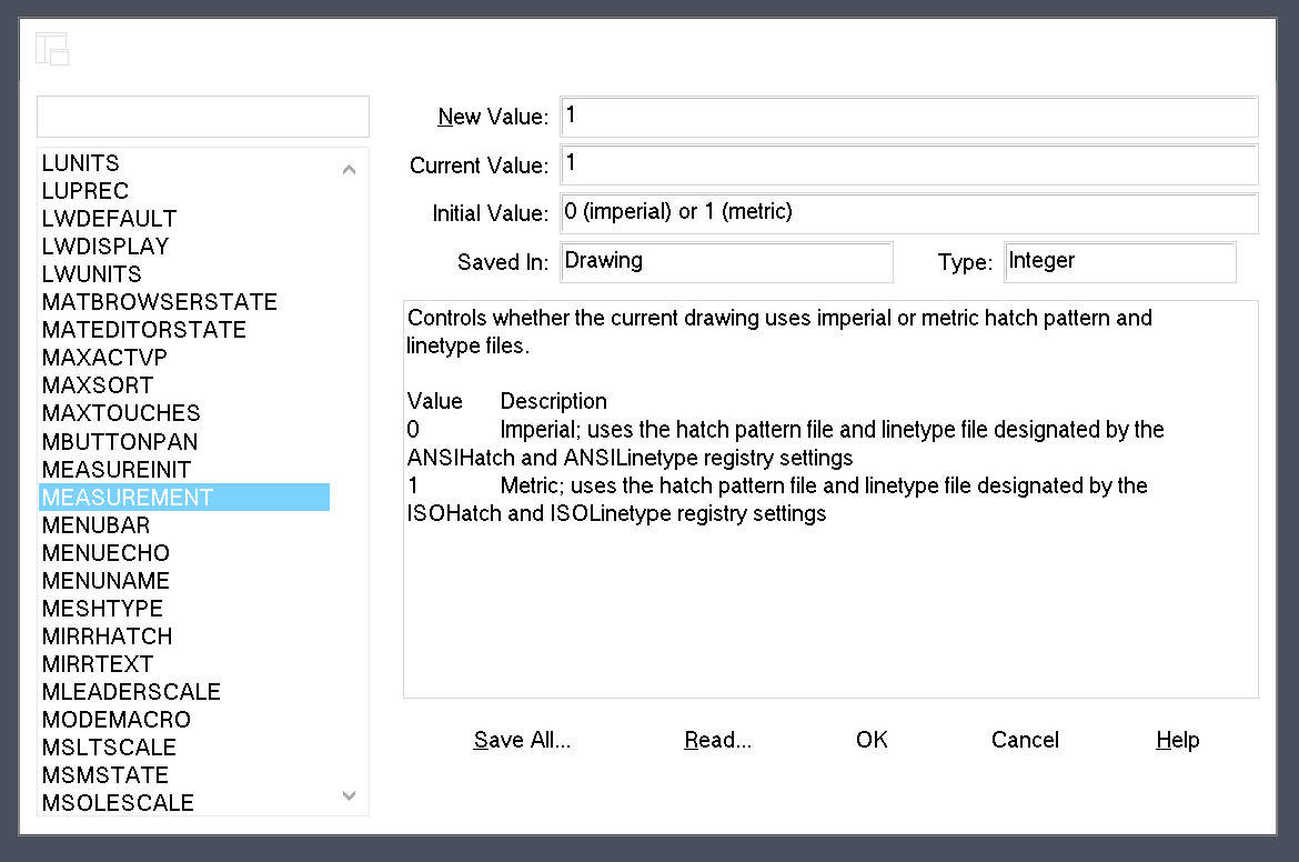

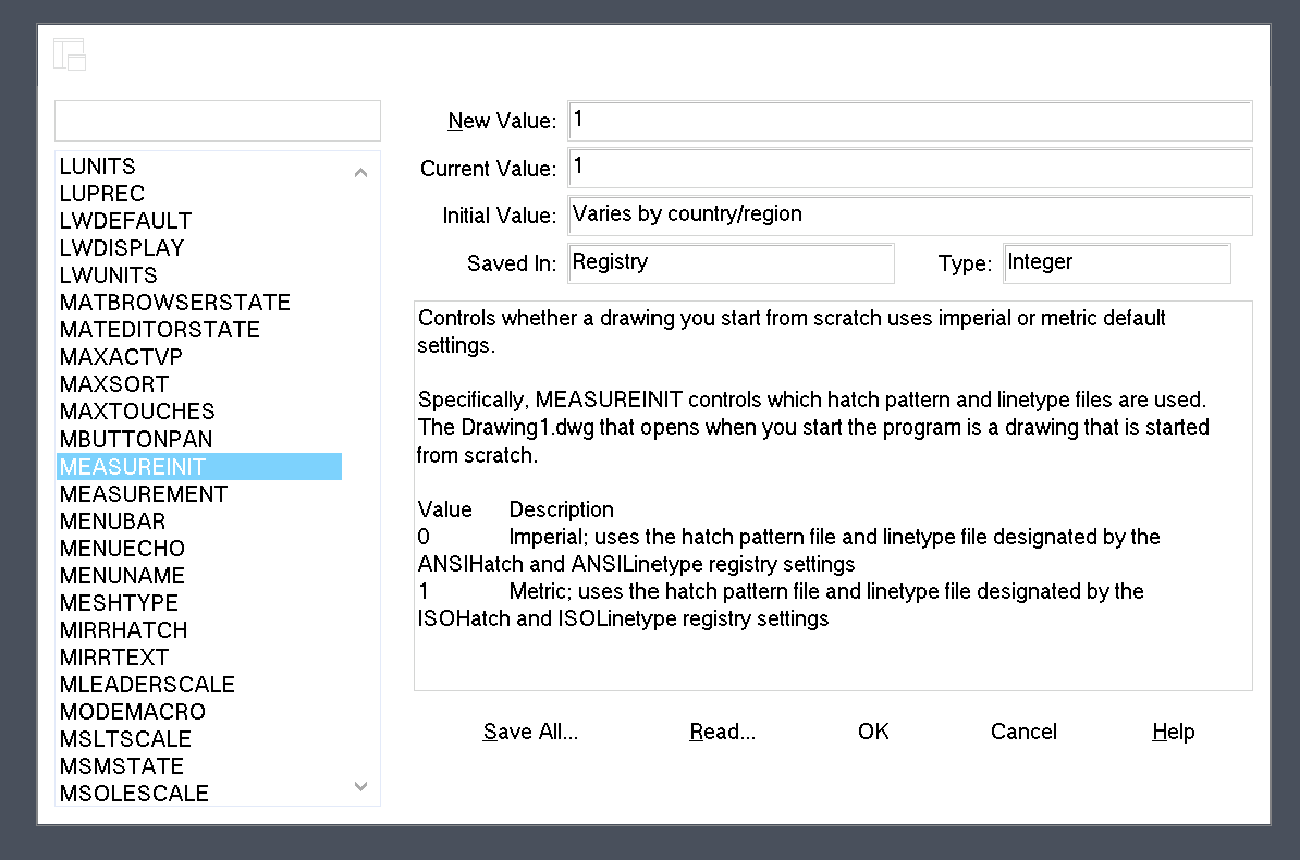

In addition to the  previous spot on suggestions, another two system variables to be aware of,
and check are MEASUREINIT and MEASUREMENT, as described in the screenshots.
Whenever saving .Dwg files to use later as .DWT (templates) due diligence is suggested.
Yes as you say use acad.lin or Acadiso.lin ?
They are text files open them up and look at the numbers they do make sense. Like 1/8"=0.125 0.375=3/8"
