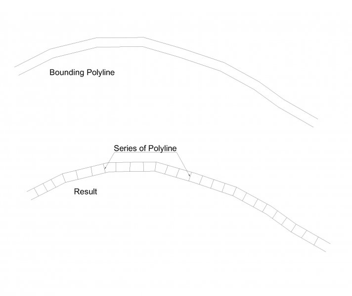

I need a lisp which will draw a series of polyline in between two bounding polyline. The series of polyline will be perpendicular with two bounding polyline. Please view the image.
Here is a sample code to draw lines between

The series of lines between the Polylines can only be perpendicular to one of the Polylines, unless the Polylines are parallel.
Nice code Fatty ! ! I learn so much reading your codes ! !
Steve
You could also make a rulesurf between the 2 plines and then extract the point values. -David

Thanks fixo for the nice code. Thank you.
Glad you got it to working,
Cheers :)
