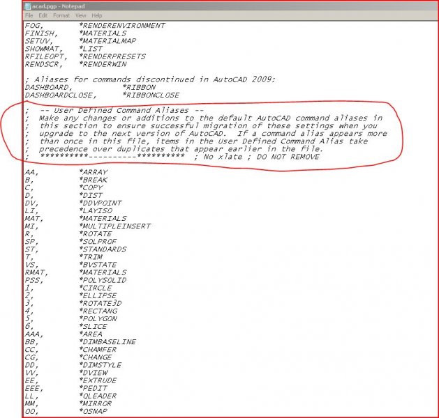

MisterJingles Posted May 15, 2012 Posted May 15, 2012 Hi all I'm wondering, to what extent can I customise my shortcut keys on my keyboard? Example, currently AC has "C" set to CIRCLE, and "CO" or "CP" as COPY. Id like to assign "C" to COPY instead as I use it constantly and would work quicker this way. Is it possible? Thanks Quote
Dadgad Posted May 15, 2012 Posted May 15, 2012 That is very simply changed. The image shows WHERE you change them, below the area which I circled. Everything you see below that point constitutes a small portion of my custom shortcalls for commands. You can access them like this TOOLS > CUSTOMIZE> EDIT PROGRAM PARAMETERS Do not change anything above the USER DEFINED COMMAND ALIASES SECTION, leave them just as they are. Quote

MisterJingles Posted May 15, 2012 Author Posted May 15, 2012 Thanks all, TOOLS>CUSTOMIZE>EDIT PROGRAM PARAMETERS worked a charm. It wouldn't recognise ALIASEDIT for some reason. Quote

ReMark Posted May 15, 2012 Posted May 15, 2012 On the Ribbon, click on the Manage tab and you'll see an icon labelled "Edit Aliases". It could not be easier. The benefit of using this method is that when you are done a REINIT is issued automatically so your changes are immediately available to you. Quote

MisterJingles Posted May 15, 2012 Author Posted May 15, 2012 On the Ribbon, click on the Manage tab and you'll see an icon labelled "Edit Aliases". It could not be easier. The benefit of using this method is that when you are done a REINIT is issued automatically so your changes are immediately available to you. This workstation is configured with AC Classic menus. In Classic I cannot find a MANAGE tab but the method described above worked well enough, other than having to restart AC as you mentioned. Quote

ReMark Posted May 15, 2012 Posted May 15, 2012 There is no reason to "restart" AutoCAD to make your changes take hold. All you have to do is issue the REINIT command at the command line. Yes, it is impossible to find a Manage tab when one is working in AutoCAD Classic mode. Express Tools is a collection of unique lisp routines that adds further functionality to AutoCAD with such commands as BCOUNT (count blocks), Convert to MText, SuperHatch, etc. Express Tools can be installed even after the fact. The option to do so is available on your installation media. Quote
