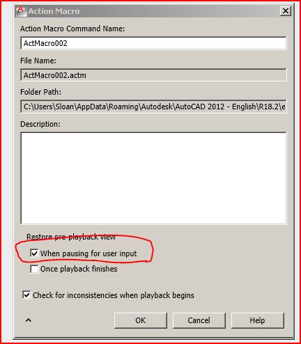

Or uncheck the circled option in the image.
