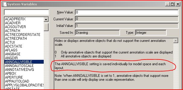

Shooting from the hip here, might it be annotative? Consider this.....
