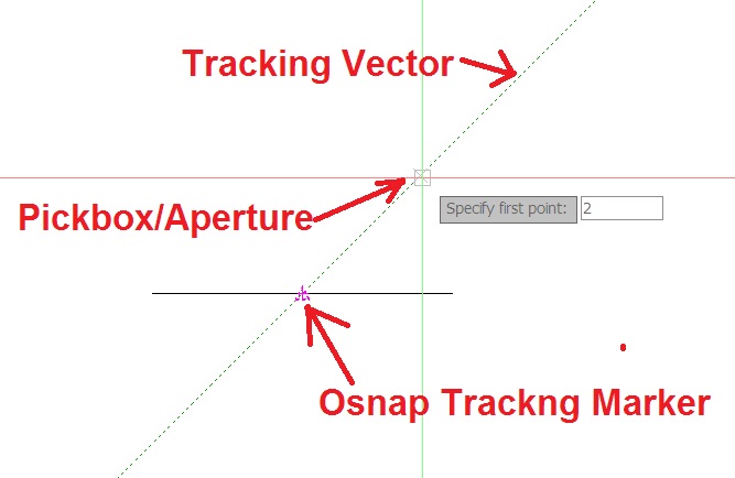

So you're saying the dashed Polar Tracking Vector and the Osnap marker both disappear when you start to type the distance?
I don't have ACA, but I couldn't find any combination of settings in my AutoCAD2013 that would reproduce the behavior. Perhaps try running ACA as AutoCAD, and see if it still happens, or if it's specific to ACA.

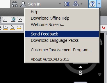

Have you submitted a support request, or a feedback report to Autodesk?
