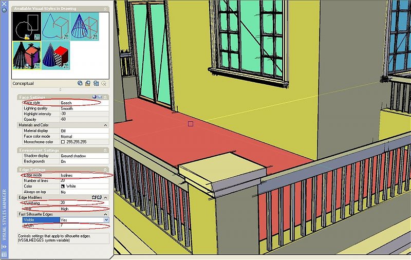

For 3D models, yes but not as good as the ones on your link. In cad there's only a way to add pencil like overhangs on edges of a model.
Try to play with the visual styles and their settings, ill post a screen.
There you go Rickard5. nocturne00's solution looks dead on.
