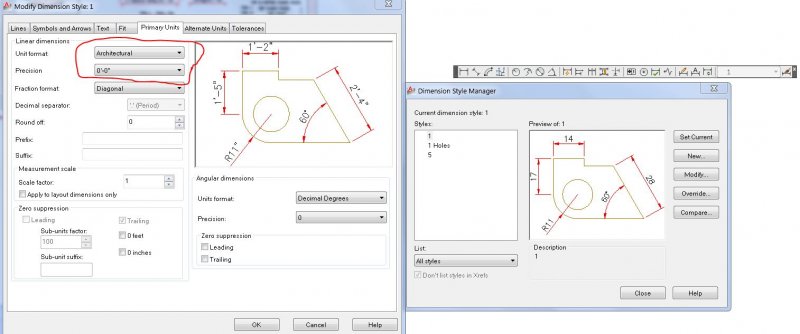

Dadgad Posted May 25, 2012 Share Posted May 25, 2012 I am not familiar with MEP, but typically on the PRIMARY UNITS tab in your DIMENSION STYLE dialog you will choose your dimension unit format from the drop down list. What you are after would be the ARCHITECTURAL format. I am not sure if your start and end tags are blocks, or not, but assume that they will derive their dimensional unit formatting from the dimension style. Quote Link to comment Share on other sites More sharing options...
