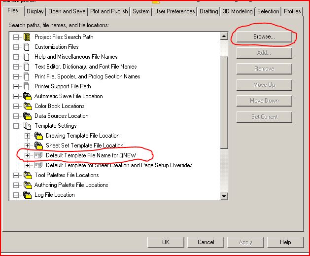

Dadgad Posted May 30, 2012 Share Posted May 30, 2012 (edited) Right click on the shortcut ICON for the program and open PROPERTIES to access the path for the shortcut. You want to add /p SEATING for instance to the end of the path, which is known as a STARTUP SWITCH. Seating should be replaced with the name of the PROFILE which you want to be targeted and opened as the default. Additionally if you wanted you could create a base drawing upon which the organizers should work, and once you are happy with it you can save it as FILE TYPE .dwt . If appropriate that newly created and saved template could be set as the default template, so that upon opening Autocad it would default to the TEMPLATE and PROFILE deemed best. This could also be done with a STARTUP SWITCH. If you want to do that you would set it in OPTIONS > FILES > TEMPLATES > DEFAULT TEMPLATE FOR QNEW. Browse to the template you want, then click OK. In that way whenever the NEW icon is selected on the MENU BAR that template will be opened. Edited May 30, 2012 by Dadgad Quote Link to comment Share on other sites More sharing options...

BlackBox Posted May 30, 2012 Share Posted May 30, 2012 Yeah, I thought I addressed that in the first 2 lines... Now that's just sloppy of me... I was distracted by the picture of Options dialog, and went on to post. The kindness of your tact is greatly appreciated. Apparently working two jobs is affecting me more than I've allowed myself to believe. Quote Link to comment Share on other sites More sharing options...
Dadgad Posted May 30, 2012 Share Posted May 30, 2012 Dadgad and Renderman, Thank you for those suggestions I will give them a try, Yes I am looking at the template avenue, however the environment they have to work in to call up base drawings I don't think supports dwt files. Will let you know how I go. Cheers Michael. Just to be clear, every drawing in Autocad is created on a TEMPLATE (unless you know how to do it FROM SCRATCH). So when you start a new drawing a predesignated TEMPLATE (.dwt file) will be opened in the program, although it will be opened as a .dwg file. Meaning that if the employees in question are using any AUTOCAD product they should be able to use such a .dwt file (your template, if you will). You can turn any .dwg file into a .dwt file, in the SAVE AS "FILE TYPE" dialog. So if you have a particular drawing that you feel is exemplary, without destroying the original drawing file, you could create a template from it. Glad it seems to be working out for you. Quote Link to comment Share on other sites More sharing options...
