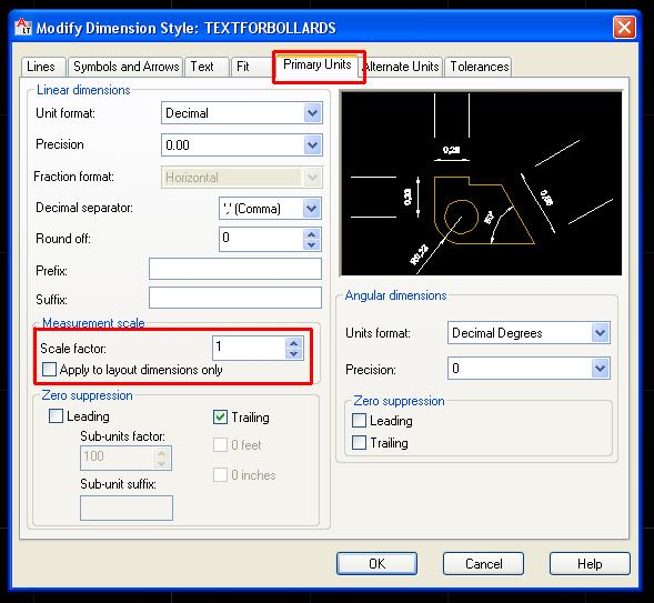

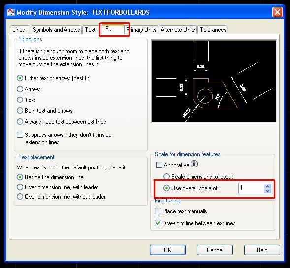

Blackfish Posted May 30, 2012 Posted May 30, 2012 As I said you have to scale your drawing using SCALE command, just type SCALE in command line, press Enter, and follow about what AutoCAD is asking, so next is base point... click on screen and then type: 1000, because your drawing is in meters and should be in mm. After that you have to adjust your dimension style (set 'Scale factor' to 0.001 and 'Overall scale" to 1000 and slightly adjust the rest as you want) and reset scale of all viewports as desired. If you need any help more just ask. However you should try to do it yourself... you will more happy at the end of the day PS. And always draw 1:1, what means in millimeters (or inches) and then set your desired scale in paper space when plotting. Quote
ara09lf Posted May 30, 2012 Author Posted May 30, 2012 I understand the scale bit. I cant figure out the dimension bit, how do i change the scale factor and overall scale? are we talking model space or paper space? Quote
Blackfish Posted May 30, 2012 Posted May 30, 2012 No, it's in Dimension Styles... Set the first one to 0.001 and the second one to 1000. Quote
