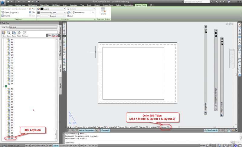

BUT this got me thinking and I need to try the max layout tabs in MAP3D seeing how a MAPBOOK creates layout tabs if it is limited to just 255.

OK tried the mapbook feature in Map3D to create more than 255 tabs. The mapbook feature allows you take a create a grid of a map (dwg) and break it up into seperate layouts. Using a grid of 20x20 for 400 tabs it create 400 layouts but only 256 tabs. So you can have more paperspace layouts than tabs with Map3dD's Mapbook or the Shhet Set Manager on steroids.
