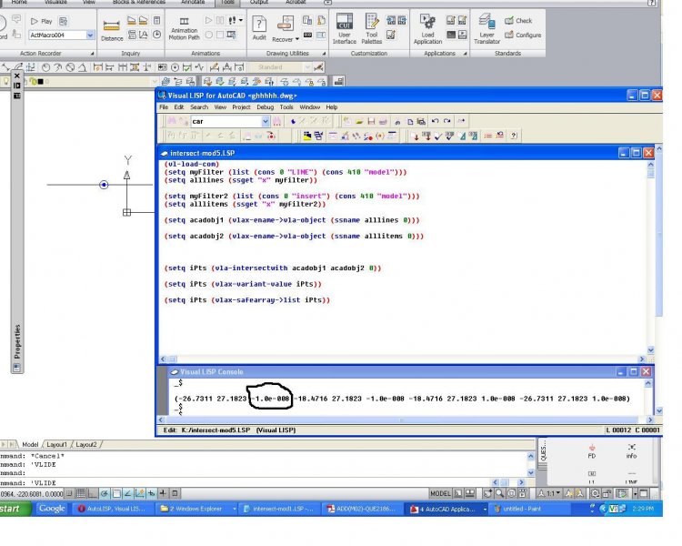

Qonfire Posted June 11, 2012 Posted June 11, 2012 After my terrible vocation in psyhiatric hospital i'm back asking questions (vl-load-com) (setq myFilter (list (cons 0 "LINE") (cons 410 "model"))) (setq alllines (ssget "x" myfilter)) (setq myFilter2 (list (cons 0 "insert") (cons 410 "model"))) (setq alllitems (ssget "x" myfilter2)) (setq acadobj1 (vlax-ename->vla-object (ssname alllines 0))) (setq acadobj2 (vlax-ename->vla-object (ssname alllitems 0))) (setq iPts (vla-intersectwith acadobj1 acadobj2 0)) (setq iPts (vlax-variant-value iPts)) (setq iPts (vlax-safearray->list iPts)) Quote

MSasu Posted June 12, 2012 Posted June 12, 2012 That "e" is used to represent very small, subunitary, coordinates: (expt 10.0 - ;will return 1.0e-008 (princ 0.00000001) ;will return 1.0e-008 May also encounter it for big numbers: (expt 10.0 ;will return 1.0e+008 Quote
pBe Posted June 12, 2012 Posted June 12, 2012 On your first question, what you're seeing is the display value, it is in fact a double-precision floating-point number. It might "look" the same and probably they are but not really. You have a misplaced closing parenthesis on the code you posted (defun get_all_inters_in_SS (SS / SSL ;length of SS PTS ;returning list aObj1 ;Object 1 aObj2 ;Object 2 N1 ;Loop counter N2 ;Loop counter iPts ;intersects ) (setq N1 0 ;index for outer loop SSL (sslength SS) ) ; Outer loop, first through second to last (while (< N1 (1- SSL)) ; Get object 1, convert to VLA object type (setq aObj1 (ssname SS N1) aObj1 (vlax-ename->vla-object aObj1) N2 (1+ N1) ) ;index for inner loop ; Inner loop, go through remaining objects (while (< N2 SSL) ; Get object 2, convert to VLA object (setq aObj2 (ssname SS N2) aObj2 (vlax-ename->vla-object aObj2) ; Find intersections of Objects iPts (vla-intersectwith aObj1 aObj2 0 ) ; variant result iPts (vlax-variant-value iPts)) ; Variant array has values? (if (> (vlax-safearray-get-u-bound iPts 1) 0 ) (progn ;array holds values, convert it (setq iPts ;to a list. (vlax-safearray->list iPts) ) ;Loop through list constructing points (while (> (length iPts) 0) (setq Pts (cons (list (car iPts) (cadr iPts) (caddr iPts) ) Pts ) iPts (cdddr iPts) ) ) ) ) (setq N2 (1+ N2)) ) ;inner loop end (setq N1 (1+ N1)) ) ;outer loop end Pts ) ;return list of points found (setq all (ssget "X" )) (get_all_inters_in_SS all) HTH Quote
Lee Mac Posted June 12, 2012 Posted June 12, 2012 http://en.wikipedia.org/wiki/Scientific_notation#E_notation Quote
Qonfire Posted June 12, 2012 Author Posted June 12, 2012 z is 10000000 ? switching to 2d workspace you think might help? Quote
