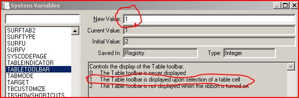

Dadgad Posted July 4, 2012 Share Posted July 4, 2012 Try checking your TABLETOOLBAR system variable setting, as shown in the attached image. Enter TABLETOOLBAR at your commandline, then change the value to 1. Quote Link to comment Share on other sites More sharing options...
