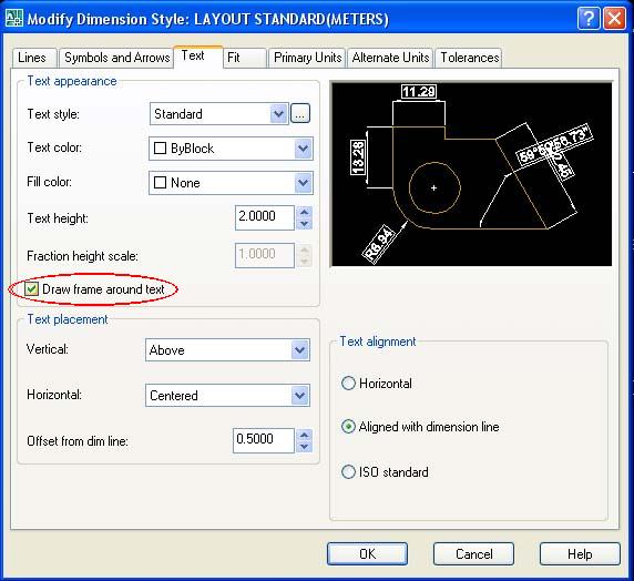

totzky Posted November 2, 2008 Share Posted November 2, 2008 I like to make my dimension text more readable by making the bounding box larger during hatching. What dimension variable will I override? Quote Link to comment Share on other sites More sharing options...

Dipali Posted November 3, 2008 Share Posted November 3, 2008 I can not chack because working in LT, But there is a command in express tool, 'draw frame around text' or 'encase text in a box' which allows you the adjust the size of the box during command Quote Link to comment Share on other sites More sharing options...
totzky Posted November 5, 2008 Author Share Posted November 5, 2008 Hi, everybody! I have red all your post and the administrator's message. Changing DIMGAP to negative value is a valid method but I don't want a visible rectangle around my text. Drawing a rectangle(w/ different layer) and turning it off is my way around it for the moment. I believe there is still a better way, a variable or parameter change perhaps??? Quote Link to comment Share on other sites More sharing options...
